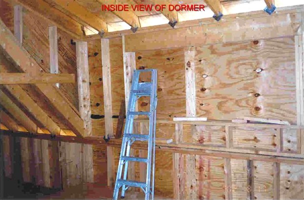

Main floor beams were constructed by nailing three 2"x 10"s together. Floor joists are 2"x 10"s, 16" oc with 3/4" T&G plywood subfloor. Wall framing is balloon type construction using 2"x 6"x 10's. Loft area measures approx. 12'x15' with an approx. 2 foot high knee wall that provides some additional head room. Rough cut, 4"x 8" exposed beams were used for the loft floor with pre-strained 2"x 6" T&G pine decking on top. This provided both a loft floor and a finished ceiling for the lower section of cabin. Loft also has a 10' shed type dormer which provides a nice view of the fields and forest. An 8' covered porch runs the entire length of cabin.
