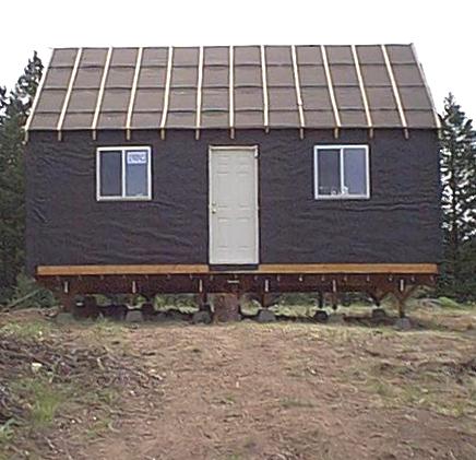

Framing up the post and pier foundation. Joists rest on the beams. A floor was built on this frame and the walls built and lifted into place from that platform. |

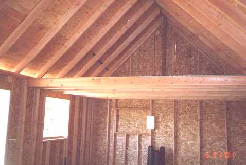

The interior framing for the future kitchen and loft area above.

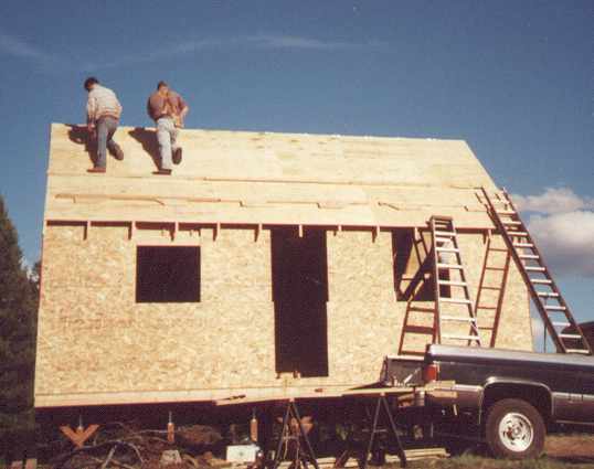

Sheathing and papering the 12 in 12 roof. Carefully! |

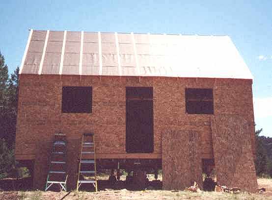

The exterior
sheathed and a temporary roof on.
Here the place is ready for rain and it can be locked up during the week.

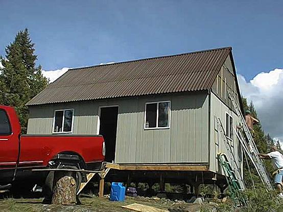

Updated June '02 Troy's been back at it this Spring. Back the truck up and get to work! The cabin made it through the winter and here they are putting up Ondura roofing and Cladwood T-111 siding. The roofing
information can be found at ondura.com.
While this T1-11 siding could have been used as a single wall covering (nailed directly to the studs) the second layer of structural sheathing adds considerably to the racking strength of the cabin. This little place will easily ride out "The Big One". Troy reports, "This has been a real fun project and I can’t wait tell it’s completed." |
