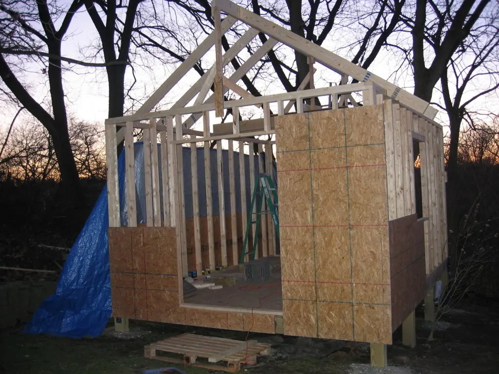

In other news.  I have 3 walls up and the 4th almost framed.  Everything is coming out and going up square and plumb so far which is making me really happy.
Here are some pictures, I'm a bit further along than this.

My circular saw broke today, got a new dewalt (the one they reccomend in fine homebuilding online).  It is night and day better than my old saw.  The guard doesn't lock up during cuts, good visibility from all angles and it is about half the weight.
Really was not expecting my rafters to fit first try so it was a pleasant surprise when everything was good to.
I've got some cool stuff in mind for the gable ends.  Hopefully it all scales well.

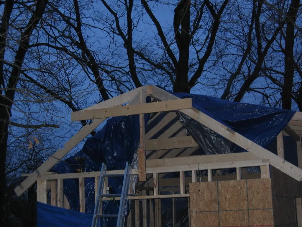

Rick that Dewalt continues to impress me.  Before, I thought I just wasn't a very good carpenter.  With the quality saw I can make cuts freehand that I wouldn't have dreamed of without a guide.
I've been working away when I get spare time.  Here is where I'm at now.  You can see it starting to take shape.  Sorry if you're on dial up!
That header up top won't really span that far.  I also decided I didn't need to stagger my sheathing in front since there is a big window over the joint anyway.
side view
Inside view.  My rafters are on 24 inch centers.   The floor joist on the end will be used to make a shelf.  My rafter tie is right about in the middle of the rafter.  I wanted it that way to have 10 ft of clearance to swing boards around inside while I'm working.  Hopefully it doesn't give me any problems.  If it does, I'll just have to fix it.
I have to figure out how much space to allow for outside trim before I finish putting the sill, header and cripples in the dormer

I reply 16 you show a pic of your shed roof extension from the inside
You have doubled up rafters and uprights, but below you have a single stud- not sure if its correct or not but I think I'd add a second stud and carry the weight down
Note I'm not a carpenter and this stick building is still new to me

I think the doubled top plate makes it okay.    ???
