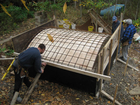

Ok.  I am designing a root cellar for my property.  It is in upstate NY, so it would have a deep frost depth.  I am looking to have a lot of dirt (4ft deep at least) on top of it.  I plan on building into the side of the mountain and burying it.  I want it to last far past my lifetime with little or no maintenance.  This leads me to veer away from wood.  I was looking for concrete, but I can’t seem to find load and span tables for concrete and steel the way there is for wood.  Mostly I was looking for rebar size, placement, and distance with concrete thickness.  I assume a curved dome would probably handle the weight best, but I can’t find out where the calculations for something like this would be.  I know this is probably a more advanced question and I am willing to do the work and learn the area.  Can anyone point me in the right direction?
Something similar to this:

Re: Underground Concrete Root Cellar Roof
« Reply #1 on: May 27, 2011, 08:22:10 AM »
I don't know about tables Squirl, but on Mikey B's place it was engineered for 12 foot span with 5/8 at 6 inches on center across with 5/8 at 12 inches on center lengthwise and was a flat floor top, ceiling below and was to support concrete masonry walls 12" thick above.  Rebar on a ceiling needs to be about 1 1/2 inches in from the bottom surface as the top concrete is in compression and the rebar in tension.
I don't see a vaulted ceiling as being as strong rebar wise ans the shortest length of rebar is straight as in a flat roof.  A vault has extra rebar so is relying on the compressive strength of the concrete to support it though the deformities in the rebar would still hold things together.

Sorry I have not had time to study this all over real well, Squirl, but it is similar to or heavier than lots of the second story building floors I work on with about a 9 foot span.  I am sure you should have no problem.  If you wanted to insure extra strength, you could up the size of the perpendicular rebar.  I assume you will be 1 1/2 to 2 inches off of the bottom of the ceiling with your bars?  The rebar is in tension and the concrete above it is in compression.
My comment about the arched roof above was meaning that the rebar would want to pull out the bottom of the arch if the walls were to give at all.  With the flat roof the rebar is in tension so it holds the sides directly together.  With the arch it can get longer since a failure of the concrete below the bar coupled with the walls pushing out from weight would not keep the arch together.  Hope that makes a bit of sense.  An arch - made properly with sides that do not move does not really need the rebar -except to hold chunks of concrete together possibly, since the entire arch is in compression.  A failing arch needs the rebar to hold pieces together - the failure would be due to the sides not being built properly - ie: buttressed and or properly designed footings.   My take on it - let me know if someone else sees it different.

Thanks for the comments glenn.  The arch would more likely be slight.  The purpose is not just structural, but functional.  Root cellars require humidity and condensation can accumulate on the roof.  Most designs recommend a slight arch for the condensation to not drip on the food.
The examples run through by the Engineering Professor at the University were for 3/4 of an inch coverage of #4 rebar.  That is also the requirement in a footnote in the I.C.C. "Concrete cover for reinforcement measured from the inside face of the wall shall not be less than 3/4-inch."  I also remember a low requirement from the concrete design books, but don't have the exact figure in front of me.  From the equations, the closer to the bottom of the slab, as long as it has the minimum coverage, the more weight the slab can bear.  In reality it would be hard to keep the rebar at exactly 3/4 of an inch.
It is probably a little beefier than some of the floors you had seen, if I did it right.  A few of the examples I read for building designs didn't use close to the dead and live loads I used for this design.  I used over 500 lbs per square foot, and most examples I read were less than 200 lbs per square foot.
I am also looking into additional fiber reinforcing.  It is more expensive, but from what I was reading the impact, crack, and failure properties were pretty amazing.

An arched ceiling of a perfect 180 degree half circle distributes all the weight straight down to the footing it sits on. Its been an architectural detail since the beging of building just about.
A less arched roof will distribute the weight in an outward spreading manner to the top of the walls.
But i am no engineer.
In new york they found a room with an arched roof made of blocks with keystones down the center. The room had been sealed for hundreds of years and was in perfect condition. And its below the city and the subway system.
