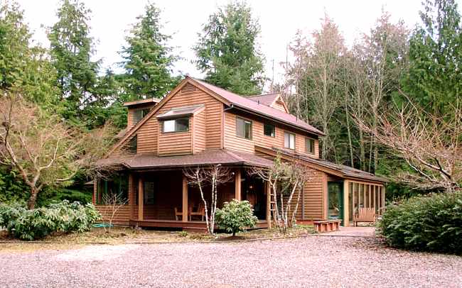

Solar Saltbox from SW
View from the top of the driveway as seen from the SW.

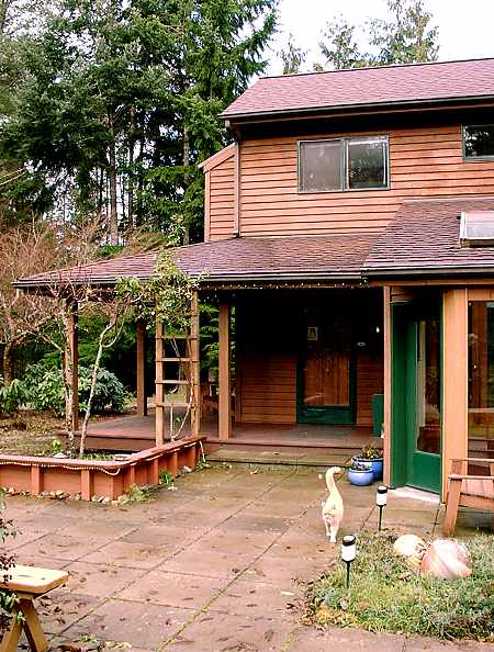

Sunroom door to right
Front door on a winter's day.

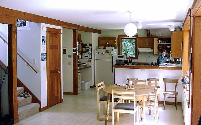

Sunroom to right through french doors
Inside the front door looking at the kitchen. Sunroom is through french doors on right.

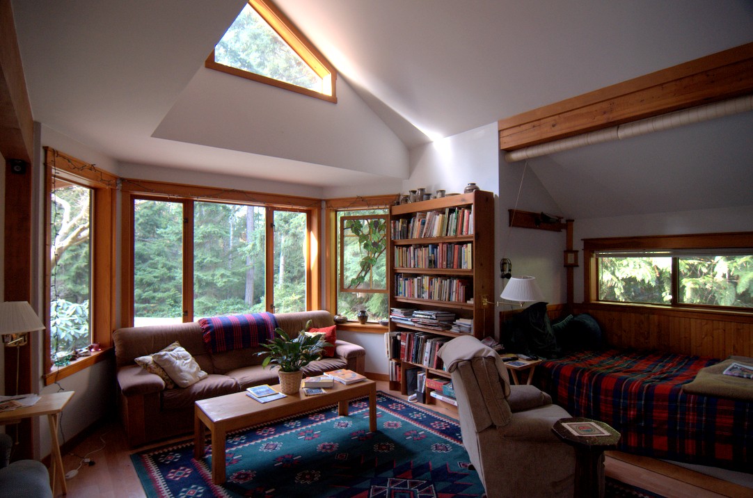

cathedral ceiling in living room - bottom of saltbox roof
The bottom of the saltbox roof can be seen in the LR above. Alcove on the right.

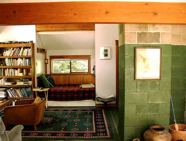

bed alcove

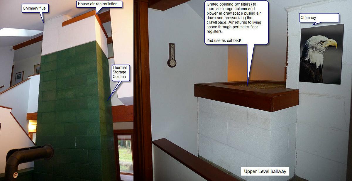

The pop-out bed alcove/TV-lounge/Guest sleeper can be seen here. The thermal storage column is on the right (a solid concrete block tower to the bottom of the upper floor roof). This picks up solar warmed air at the ceiling and sends it down to the insulated crawlspace plenum and then back to the interior of the house through floor registers.
Some visitors have asked for more information on how the thermal storage column works. See the diagram below and additional information on the system can be found in the PDF file.
solar heat storage air column

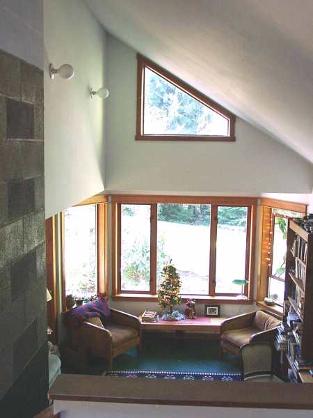

from stair landing
View out the Living Room bay window from the stair landing. The thermal storage column is on the left.

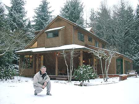

Solar saltbox in the snow
Winter time scene.
