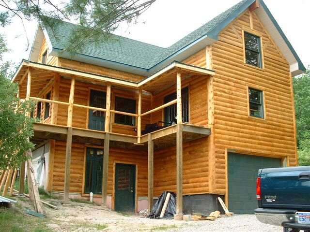

log siding
Here is the log siding applied to the SIP panels.

View from the deck with the rustic posts.

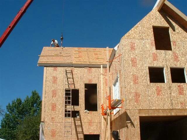

SIP panels going in place on the roof
SIP panels going in place on the roof. Careful old guy at work!

First I reduced the original Victoria Cottage plans to a CAD drawing on my computer so I could lay out the panels prior to ordering them from the manufacturer. The walls are 6" thick SIP panels and the roof is 10" thick. The roof was the scary part. It needed to go together from manufactured parts according to specs I sent to the factory. Some what like a 3-d puzzle. There is a picture above of these panels going into place. Up till this point I did all the work alone. 12' long x 6" thick panels are very heavy so I rigged a pulley system on wheels using a boat winch to move and lift them into place. Still a lot of work for an old guy like me. This system is very sturdy but no faster nor easier than stick built. The insulation factor is really impressive however.

The later pictures are what I have done since getting back this spring. We decided on the log finish even though it was a little more money. We did make a nice deal with the mill and got some older stock that had a few water marks on it at 1/2 price. The total outside materials package in white cedar with corners, window bucks, and beams, plus the t&g white cedar ceilings and inside mouldings cost just over $8000. For anyone contemplating this type of work, power nailers are a life saver. Also if you need to work as high as part of this home is, renting a man lift is the way to go. I have rented one several times, including putting the roofing on. A 12/12 roof is too steep to stand on when you are 30' off the ground!
As can be seen in the porch pictures, we are using white cedar poles where we can. We will be going out in the swamps to cut more for use inside for the stair and balcony rails as well as support poles. We may in fact trade some inside supports for cedar as well. The ceiling will be in cedar but the walls will be drywall and then creatively painted. All mouldings around inside windows and doors are to be in hewn white cedar. A lot of this will need to wait until later as recovery from surgery will take some time. In the meantime, we will be doing electrical and some inside work up till the end of the month.
