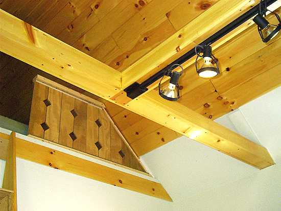

loft and ceiling finish
Looking overhead we can see the loft and boxed in rafter ties. The ceiling is finished in pine boards.
